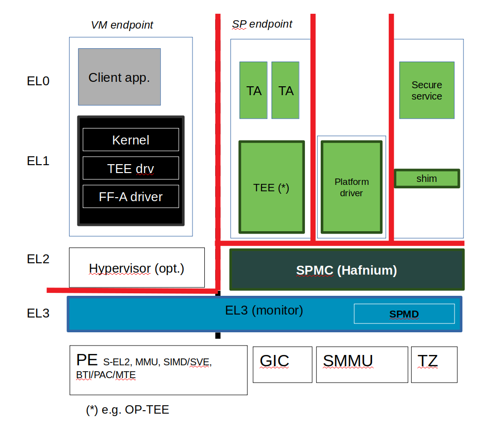

4.3.1. Trust boundaries
  • Normal world is untrusted.
  • Secure world and normal world are separate trust boundaries.
  • EL3 monitor, SPMD and SPMC are trusted.
  • Bootloaders (in particular BL1/BL2 if using TF-A) and run-time BL31 are implicitely trusted by the usage of secure boot.
  • EL3 monitor, SPMD, SPMC do not trust SPs.
_images/spm-threat-model-trust-boundaries.png
Figure 2: Trust boundaries
