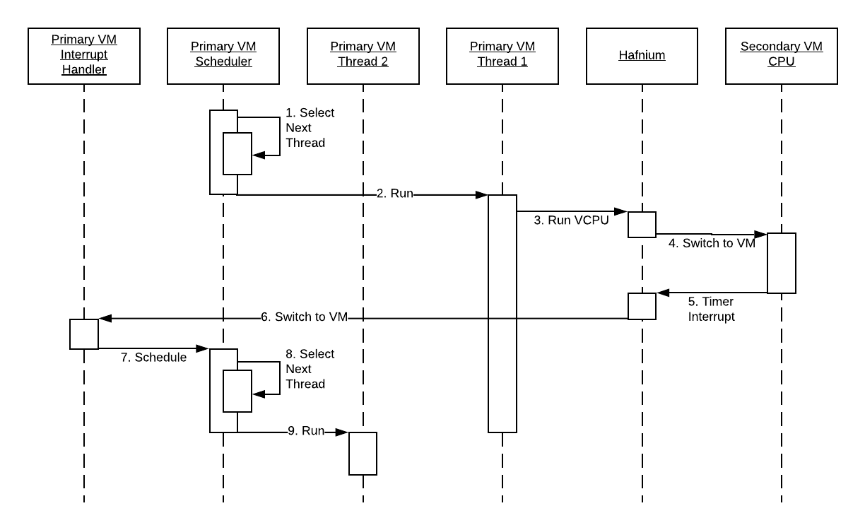

8.1.2.4.1.1. Example
For example, considering a simple system with a single physical CPU, and a single secondary VM with one vCPU, where the primary VM kernel has created thread 1 to run the secondary VM’s vCPU while thread 2 is some other normal thread:
scheduler example sequence diagram
  1. Scheduler chooses thread 1 to run.
  2. Scheduler runs thread 1, and configures a physical timer to expire once the quantum runs out.
  3. Thread 1 is responsible for running a vCPU, so it asks Hafnium to run it.
  4. Hafnium switches to the secondary VM vCPU.
  5. Eventually the quantum runs out and the physical timer interrupts the CPU.
  6. Hafnium traps the interrupt. Physical interrupts are owned by the primary VM, so it switches back to the primary VM.
  7. The interrupt handler in the primary VM gets invoked, and calls the scheduler.
  8. Scheduler chooses a different thread to run (thread 2).
  9. Scheduler runs thread 2.
